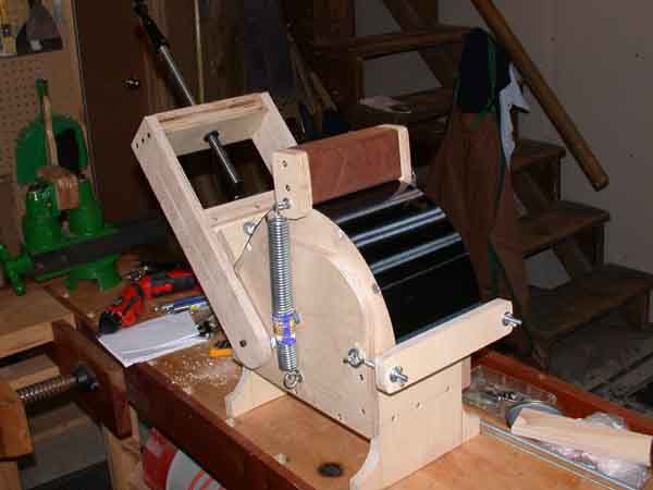

OK here we go again,
picture of the bender

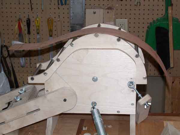

PostPosted: Thu Apr 12, 2007 5:19 am
Joined: Thu Dec 14, 2006 6:44 am
Posts: 319
First name: Ron
Last Name: Belanger
bent side compared to bender
PostPosted: Thu Apr 12, 2007 5:20 am
Posts: 319
First name: Ron
Last Name: Belanger
bent side compared to mold and other side finished with a bending iron

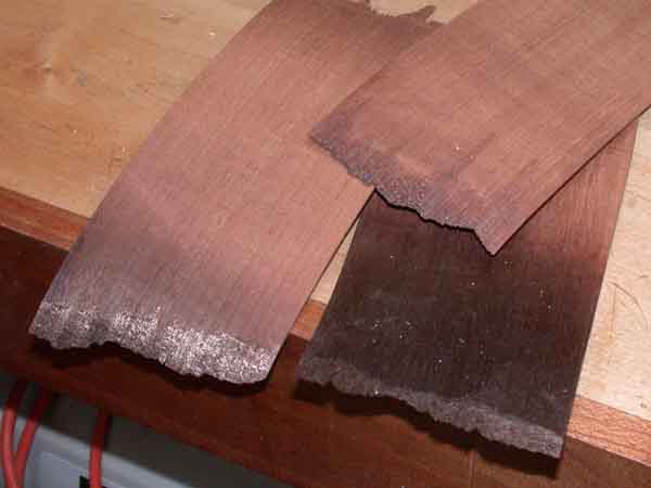

550 degrees F is just a little too hot. Ah well, ***** happens.

This also helps (a bit) to prevent burning as well. Your pic of the broken sides look like a classic 'too dry to bend' example. You can only get away with less water if you have a very resinous wood like EI Rosewood, in my limited experience-even then, water helps.
